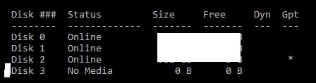

Hello,
My pen drive is not showing and crazy thing is it is showing in disk part with no space.
Also it works only with USB 3 when i connect it to USB 2 port its not showing anything.

The reason that the USB flash doesn't work on a USB 2 port could be the fact that the driver for the USB host controller is outdated. Do you have separate USB controllers for the USB 2.0 and USB 3.0 ports? If so, navigate to the Device manager and manually update the driver for the root hub controller.
You can do that either by entering in Properties on the device or by downloading the latest driver on the controller manufacturer's official website.

Feb 24, 2017 at 10:02 AM
I already try that but still it will not solve the space issue :/

What happenes if you connect another external device to the USB 2.0 port? Does it give you the same error?
ebhathiya Posts 3 Registration date Wednesday February 22, 2017 Status Member Last seen February 24, 2017 > KY_WD Posts 2053 Registration date Thursday October 23, 2014 Status Member Last seen February 28, 2017
Feb 24, 2017 at 10:30 AM
Nop it works fine :/ jst this one..
